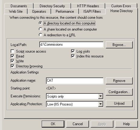

How are the permissions setup in IIS ? Do you have the default IIS account enabled or disabled for anonymous login? Do you use integrated windows authentication or another option ? In the home directory tab, which options do you have selected (ie read, write, execute etc)?
Posted By: Gary
Date Posted: 06 November 2007 at 3:01pm
IIS is configured as follows:
Integrated Windows autentication only
(not sure about the default IIS account though - how can I find this?)
Posted By: socialanimal
Date Posted: 06 November 2007 at 3:47pm
To view it go into the directory security and edit tab, that will bring up the above dialog screen. I'm just checking things now ... I honestly don't think it would be the cache now we've tested other things but I could be wrong.
Posted By: Gary
Date Posted: 06 November 2007 at 4:45pm
IIS is using Windows Authetication only we need to capture the user's id with Request.ServerVariables("LOGON_USER")
